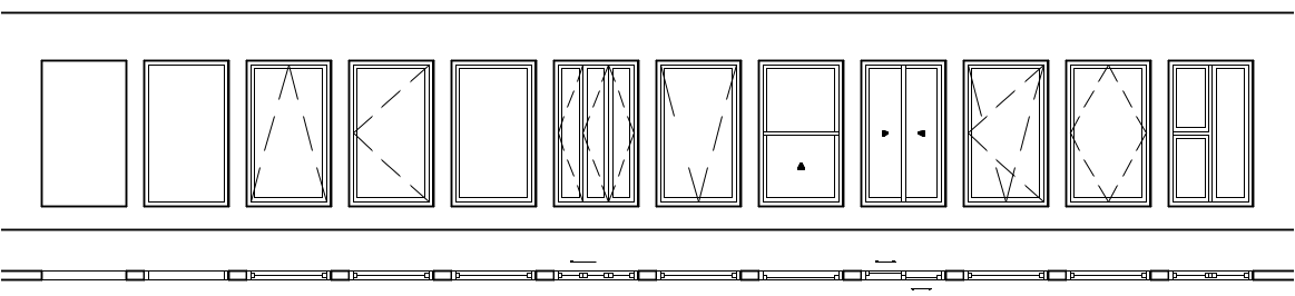

Configuration: This dropdown lets you choose the window's configuration from a list of available options. Alternatively, you can check the Use symbol geometry checkbox (just below the Rise and Spring fields above) to use a custom symbol.
The available window configurations are
- Opening
- Cased Opening
- Awning (US), Top Hung Casement (UK)
- Casement
- Single
- Bi-part
- Fixed Glass
- Sash
- No Sash
- Folding
- Hopper (US), Bottom Hung Casement (UK)
- Hung
- Single Hung
- Double Hung
- Sliding
- various configurations, X = Window, O = Panel (XO shown)
- Picture Window Slider
- Tilt/Turn
- Vertical Pivot
- Custom
